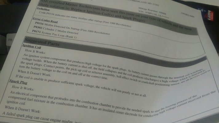

So since it actually kept the code this time, off to autozone I went, and I got those three codes. Misfire on startup [first 1000 revs], cylinder 2 misfire, and system too lean.
What I want to know is, when I take the poor girl to the mechanic, what should I be telling them, if anything? And alternatively, is it even safe to drive? For some reason, the shaking seems to be an "either it happens or not" situation but I don't want to just drive around if I'm hurting it.

You've got 3 problems. 1, p302, your #2 cylinders misfiring, coil, plug, injector, 2, you've got a generic misfire, that 0316, and 3, you got a vacuum leak, your 171. Got to do the usual, replace plug, coil, boot for #2, smoke the motor to find your p171 leak, and the 316 may disappear fixing the other 2.

I'd probably have the intake system smoke checked. The P0302 is a misfire on the #2 cylinder on the passenger side of the motor ( second from the front ...). Could be a bad coil if those haven't been changed lately. You said you had the sparkplugs done recently. The coils are cheap, and the #2 coil is relatively easy to change out. The P0171 code is a vacuum leak from a hose or leaky intake gasket on the driver's side. That is where the smoke machine earns it's money. If you don't want to buy your own, call around and see if a shop in your area has a smoke machine and can test your Expy's intake system for a leak. The P0316 code is just triggered when the total number of misfires hits a pre-set number ( like 1,000 or so ...). If you get the other two things fixed that will go away.
