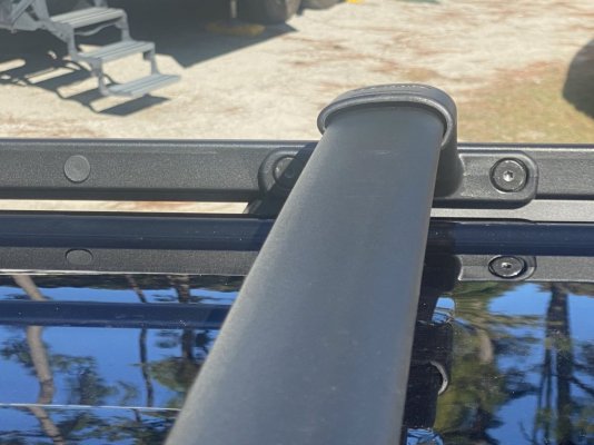

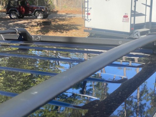

I drilled a 23/64 hole and inserted a 6mm rivnut which worked great. This allowed me to use the front oem roof rail position for the rear crossbar hole, and the new rail rivnut hole for the crossbar front mount. I filled the oem rivenut with the plastic insert which you can see to the rear.

Great tips. I assume you used a rivet nut setting tool to install the rivnut? Aluminum rivet nut?
s1000pre
s1000pre
Nov 16, 2022
26
minneapolis
Yes, Astro Pneumatic tool. I used stainless rivenuts. Aluminum won’t hold as well, and the roof rails are metal, not aluminum. I didn’t want to risk the chance of galvanic corrosion.
