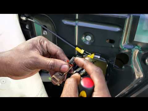

I had this same issue on my 3rd gen and in my case it was the door switch. Sometimes they would stay on. Other times they would come on at random while driving. You can soak the mechanism down with rust penetrant or silicone and if it works, continue to do so every time the problem returns until it no longer works. The actual fix though (assuming the source of your problem is the same) is replacing the switch. Cheap, but a PITA.
