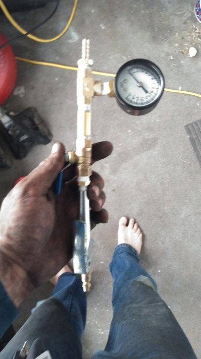

First was a matter of getting a 1/2" ball valve and a 1/4" Barb fitting to fit on my air compressor.

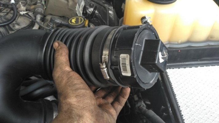

Next was removing the filter intake and installing a plug to seal the system up. Then plugging into the left side of the solenoid I started putting pressure on the system and almost immediately I started hearing a leak... 3 leaks later it was holding pressure to about 15 psi (max for the gauge I was using. Please note by doing this you are testing the boost piping, intake piping, cac, and the feeds to the turbo. So it tests pretty much all the pipes from the filter box to the manifold!!
