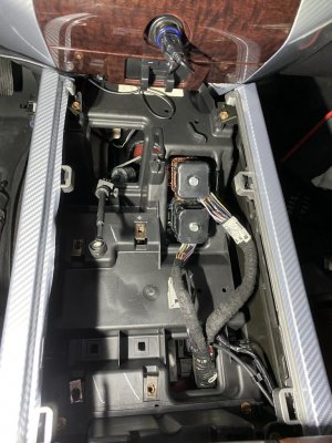

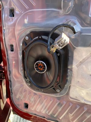

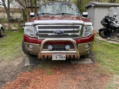

Yeah I’ll get around to it, I’ve been asked for videos before. I just start working on things and the last thing I think of is making a video with my iPhone. I should get a tripod off Amazon and set it up. I have pics of some of my work.18319383-5229-4C77-8861-E2B86D6CE912.jpeg08E9C6AF-12AD-45AA-8448-3E517A7C2F0E.jpeg07120FCC-CA5D-4C25-894B-73EC4440B808.jpeg05E36ACD-E966-467C-8290-16348939DA57.jpeg

The box is made to be removed and unplugged easily. There is a power disconnect under the hood with a key.
