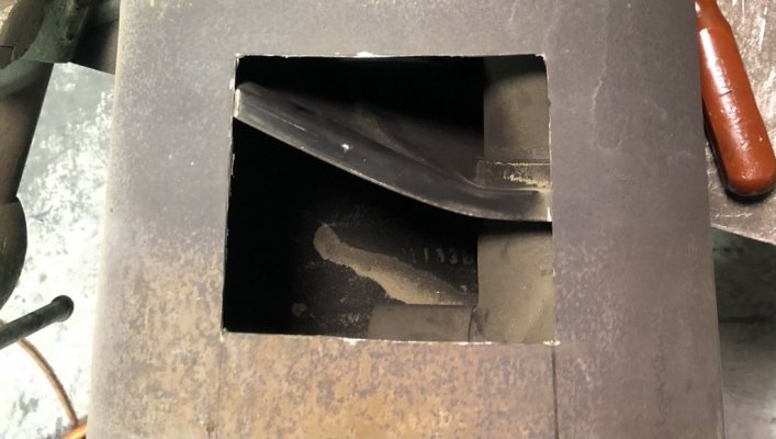

I have a 2018 approaching 150k. I have a bad backfire (gunshot) after filling up with fuel. I do not top off the tank, and last time I got fuel I stopped a few gallons short. The back fire actually broke the muffler internally.
Couple things: my cats are removed and the sensors turned off for reasons I posted elsewhere. Car has been like this for a few months without issue. Also, I have an o2 sensor that throws a code off and on. But this code also preceded the backfire issue.
Again, this only happens after fueling up. Any thoughts?

Is it tuned, or just stock tuning with the sensors turned off? What ever is causing the post detonation is going to break something more than the muffler if it continues. It is probably doing it more than when you fuel, but things are hot, because, well you drove to the gas station causing the post detonation.
