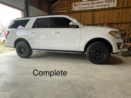

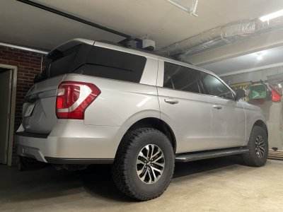

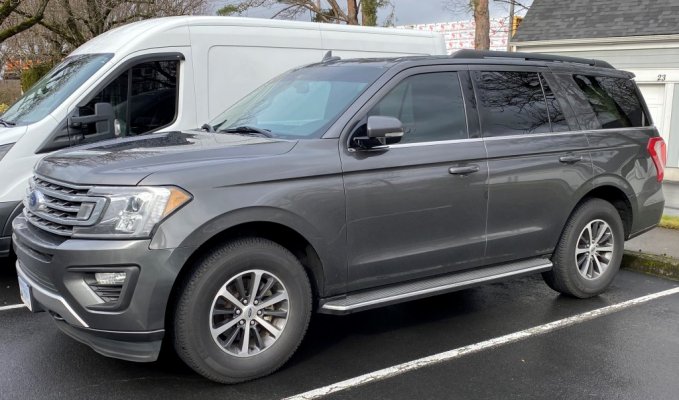

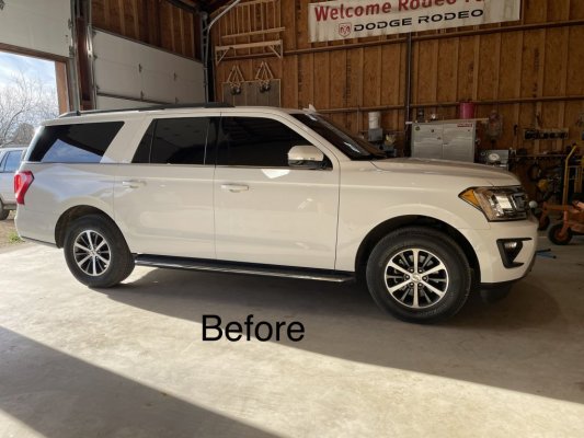

I just switched from the RL 3/2 spacers to the Expedition specific Bilstein 5100's front (24-285056) and rear (24-285063) on my 2018 XLT (non-CCD obviously). The only thing I regret about making the switch is not doing it sooner! Before I removed the RL spacers, I measured from the center of the hub to the bottom of the fender and all 4 corners measured 22.875". After installing the Bilsteins at their highest settings, all 4 corners measured 22.75". So I only lost about an 1/8" in height all around, but I gained much improved ride and handling characteristics.
I got the Bilsteins from Summit Racing for $534, though they used to be able to be found for a little less elsewhere. Given the marginal difference in cost between the RL spacers and Bilsteins, I would NOT recommend the RL to anyone.

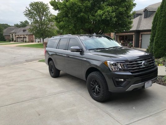

I have the RL and no issues to date. Im sure the Bilstein rides better....but i find no issues. Oh and raptor wheels are the *******.

No I did not have the Bilsteins on with the RL. I wouldn't recommend the RL over the Bilsteins because of the severe upper control arm angles and decreased downward travel which resulted in a rough ride, exaggerated top-heavy feeling, and decreased wheel travel off road. Others have described the 5100's as having a firmer ride than the factory shocks. In my case, with the 5100's installed, the ride feels positively plush compared to the RL spacers and factory shocks. Just my experience. YMMV.

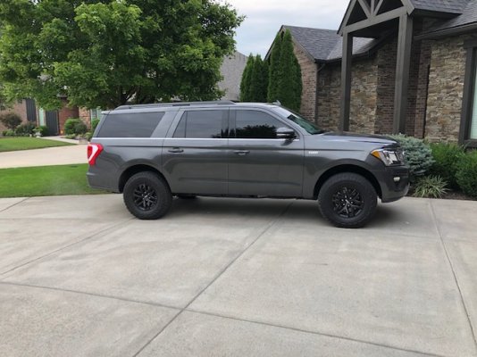

I had to do a double-take. Those Raptor wheels look good black! What size tires are on them?
sanman28
Jun 24, 2019
195
150
SW MO
295-70-17. Powder coated black OEM wheels. 1/4” spacers. Obviously took off the FX4 running boards. No rubbing, trimming, or pulling.
