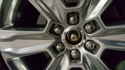

Just an Idea, Maybe use a wheel offset Spacer for the Rear... It would push out the Rear wheels just enough to clear the caps, and also make the back "stance" wider... only by a 1/2" per side... or whatever size you buy.

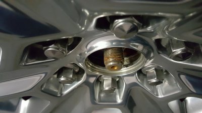

I had the same exact issue. Bought some 20" wheels from a 2016 F150 for my '14 Expedition. I took it to a small shop and had the cut cut the extra off ($25 out of pocket) and no problems since, and they look great.

Just have a machine shop do an extension of the center cap with the same material so it could clear the spindle. Then have it electroplated. Nobody would notice the difference.

cut the back off the center cap use some pvc pipe to extended it out were it will clear 2 ton epoxy the pvc pipe to the back of the center cap you cut off and glue the front to the other side of the center cap and paint just the pvc section with some silver or grey idk just my idea lol
