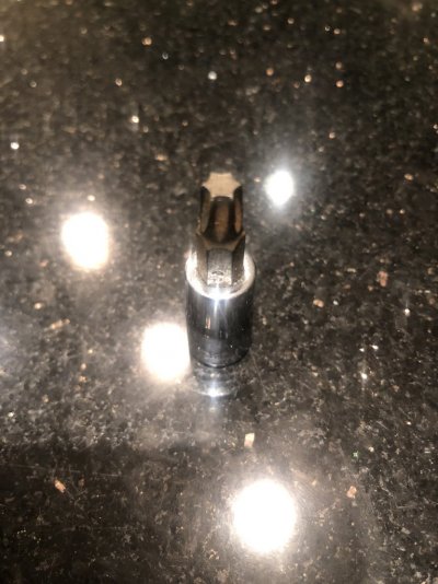

Hi, it’s a T30 torx socket like this one.

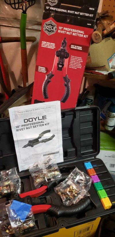

If you want to make new positions for your racks, get this from harbor freight.
10" professional rivet nut driver kit. It's got M6 rivets, and works great.

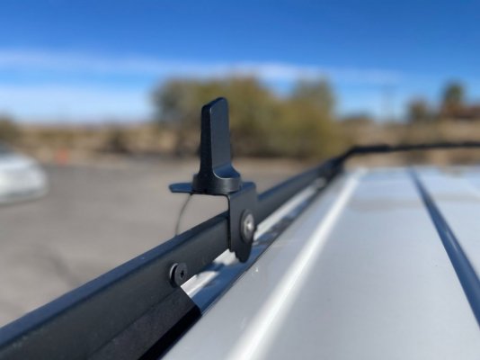

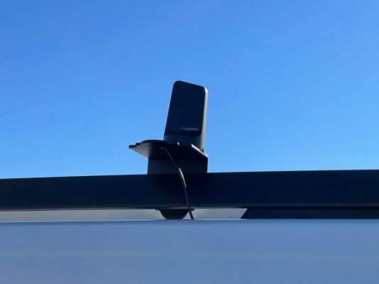

Thanks everyone. Needed a small, flat spot for the mag mount antenna.
Got a powder coated Simpson Strong-Tie angle bracket, large rubber washer, fender washer, and stainless screw from Lowes.
