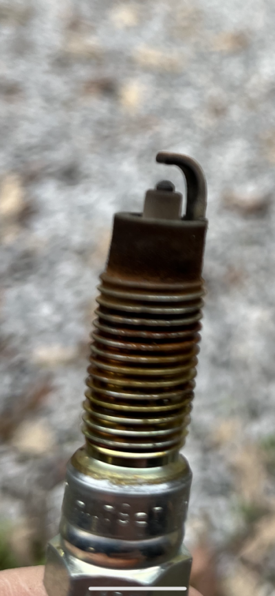

I changed the firewall plug on driver side, the tip has completely burned off,
These plugs have 120k on them
I’m thinking the Miss fire was the gap to much and to much fuel when I went to pass a vehicle the spark wasn’t there to burn it all
