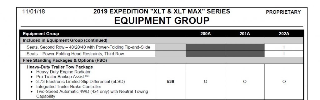

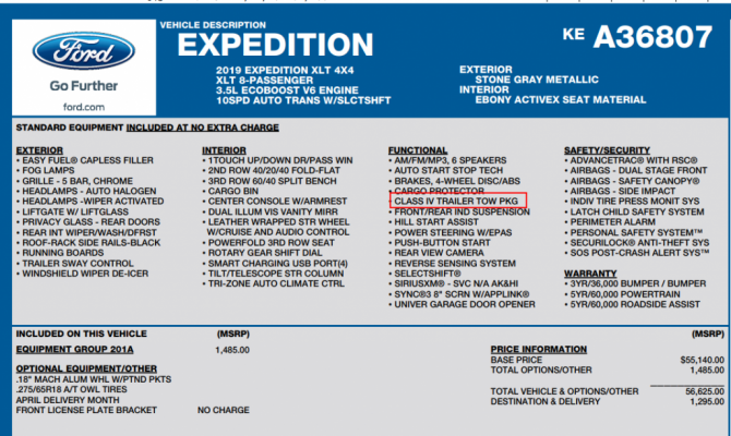

Just curious, do you have "HD tow" package? Or just a class IV hitch? Reason I ask is because HD tow comes with a transmission cooler.
If you don't have the cooler it's likely the transmission was overheated and will need to be rebuilt or replaced.
