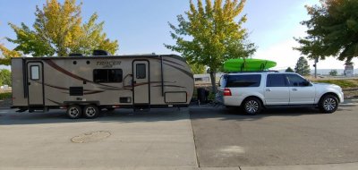

@coolzzy, can you post a pic on what your set up looks like hooked up? I think I should change my hitch to a equalizer because I have a mean squat in the rear.
coolzzy
Apr 16, 2018
374
166
Idaho
This is fully loaded with fresh water tank full, 2 inflatable paddle boards, generator and firewood in the back of the expy, but no kids on board. Keep in mind the front wheel arches are higher than the rears so it can tend to look like a little squat but it's not really.

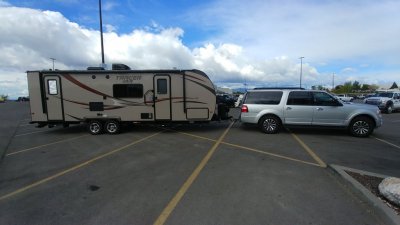

coolzzy
Apr 16, 2018
374
166
Idaho
Here's another shot minus the kayak but still full tank of fresh water. Generator on this trip was in the Bathroom at back of the trailer.
