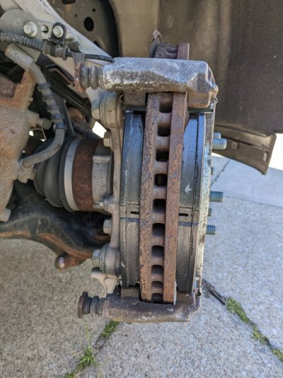

Jumping into the process photos after jacking the car up, securing it with a jack stand, and then removing the wheel:

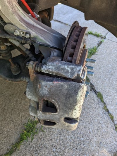

Caliper bolts are 13mm:

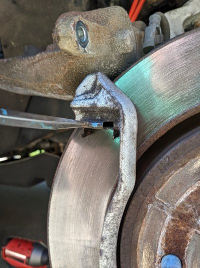

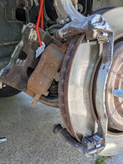

Pry the caliper off with a flat head screw driver, preferably something with some strength:

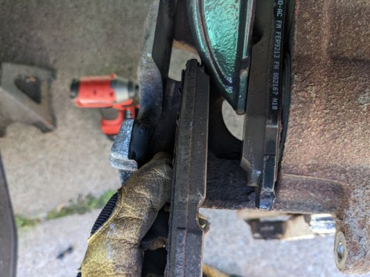

Now pry the pads out of the caliper. I will note here that on the other (driver) side, my inside pad was stuck. The front pads had lots of material remaining and I was actually going to save them, but I destroyed the friction face on the other pad prying it out.

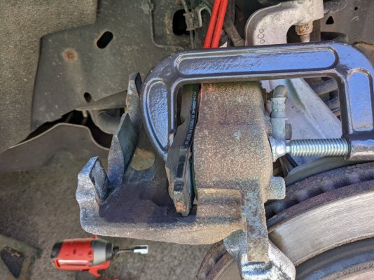

With the old pads removed, I used one to compress the pistons back into the caliper using a regular 6" C-clamp. Make sure you compress the pistons all the way - I did not on the first try and when reinstalling the caliper over the new pads one of the pistons would not clear a tab that was on the backing plate of the new pads. I had to pull the caliper back off and then compress again to get it to fit over that tab.
My back brakes were down to metal, but the fronts were still in decent shape. I almost stopped the job and left these on but I figured what the heck, I've got it torn down already, might as well swap them out...
