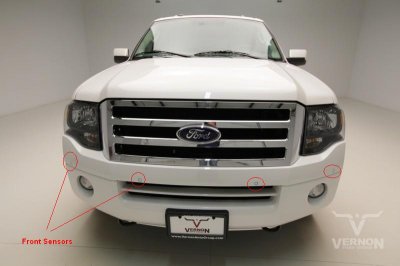

Front sensors are mounted into the front bumper ( perfectly flush and blended ) - no way to "relocate" them without leaving holes.
Can you turn off the "parking aid" via the message center on the dash? It will probably shut off the reverse ones also though.
Maybe the dealer can reprogram the PCM ????

tonydiv,
I wasn't saying it was impossible. Believe me I know "anything" can be done with a little ingenuity, time and money. I was just letting you know that it wasnt the easiest thing to do.
Years ago Ford used these big backup sensors that stuck out of the rear bumper and definately looked like an afterthought, now they are almost seemlessly intergrated into the bumper, so popping them out and popping dummy ones in isn't a simple task if you are trying to maintain that indiscreet look.

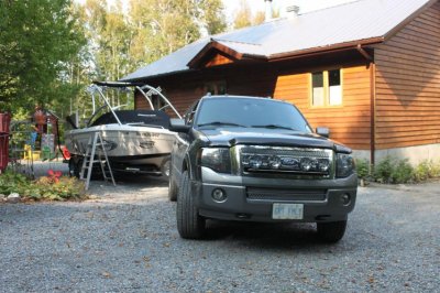

jrscott
Nov 10, 2011
44
24
Ont Canada
You can turn them off if you go into setup as discribed above. I wanted to add a bar to the front to mount some extra lights but when learning it would affect my front park sensors i decided to have something fabricated
