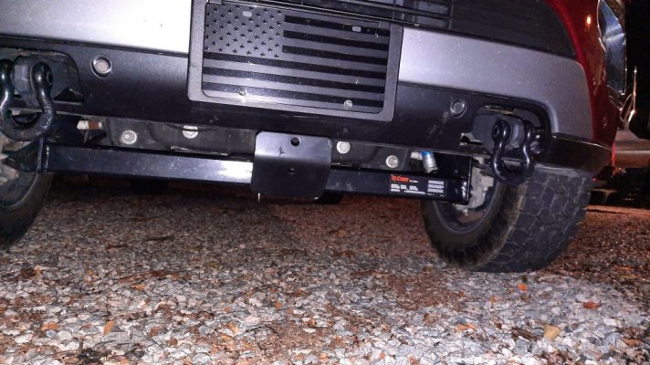

I would like to see a picture also of this front hitch mounted on an Expedition. All I can find are pictures of it install on the F150. I have removed my air dam so I no it will be exposed but I'm worried it may sit too low. Curt stated when mounted it sits about 1 inch below the bottom of the bumper.

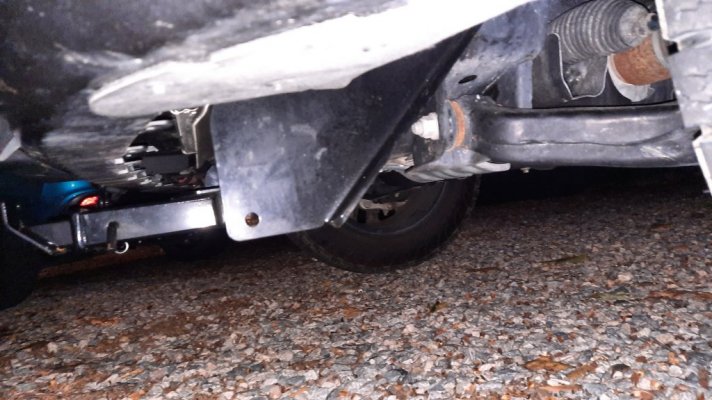

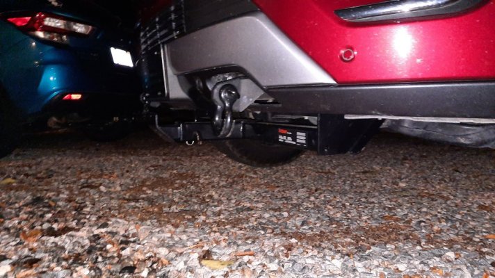

Alright here are some pictures. Bought a winch but haven't tested yet. Used it with the bikes last weekend for trip to Hatteras and worked great.
