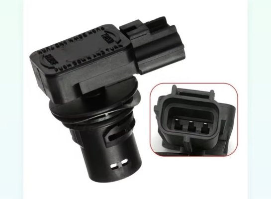

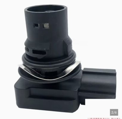

It is above the fuel tank on the rail. The fuel pump connector is behind it. Got my tank out, maybe tomorrow I will send a picture.
BlackCoffee
Mar 26, 2019
175
95
SOMD
Here is the pressure sensor. Above the cross member where it meets the driver side frame rail. Spliced into the vent hose that goes back to the filler tube.
