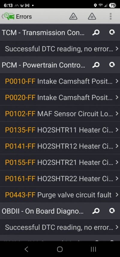

Figured I'd post my success in finding why fuse 74 kept going, hopefully save someone else some headache.
It runs the O2 sensor heaters, MAF, fuel vapor purge valve, camshaft phaser solenoids, and the Charge Motion Control Valve (or Intake Manifold Runner Control Valve).

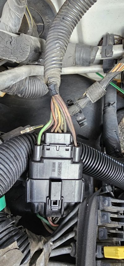

Its in the back of the intake manifold, and almost impossible to unplug without removing the manifold first. However, the wire from the motor in it is accessible at the harness connector above the passenger wheel well, near the ECM. The wire at the connector is black with a yellow stripe, with the connector unplugged, grab the white plastic part with pliers and pull it out. A small screwdriver can lift the plastic latch off the pin and let you pull the wire out the back. Reinstall the plastic part, and connect the cables, tape off the loose pin.
Turn the key, reset codes, breaker didn't pop, no further codes.
