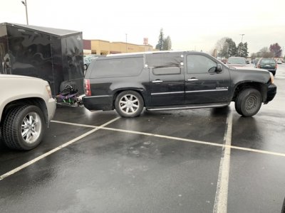

Not a trailer person here.... so what it the answer. Put less weight in the front of trailer and more over its wheels?
Or get helper springs air bags etc or both??

The black plastic bag over the rear window and trailers condition tell me all I need to know here. Bonus is his mismatched rim up front.

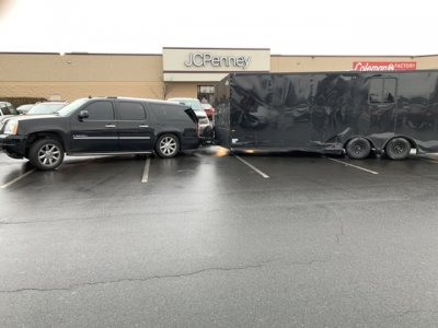

That setup has clusterf@#$ written all over it. Based on how close the trailer tires are to rubbing the box, the trailer must be waaaay overloaded. Then you tie that onto the tow vehicle with no weight distribution.
With the damage on the trailer box, tow vehicle window, and spare tire rim mounted up front, I wonder if this rig already found the ditch before these photos were taken.

Can’t help but wonder if he got to where he was going safely?
He may have gotten to where he was headed, but it sure as hell wasn't safely. Every bump would have reduced the steering even more than it was already in the pic. Braking? Please... Maybe in about a mile. Any cop should have pulled that idiot over. That set up was just waiting to kill someone on the road.

TobyU, As you state, I suspect moving items around inside the trailer to reduce nose weight was an option, I suspect the whole rig weighted more than that car is rated to pull!! But also some kind of weight distribution hitch (plus moving items inside the trailer) was definitely in order, it must have been terrible to drive!! I sure hope he had a brake controller as well to help with braking!!

Not for nothing, as we're all bashing him, he might have had his air bags go out. I doubt it for a few reasons, but it's possible...
