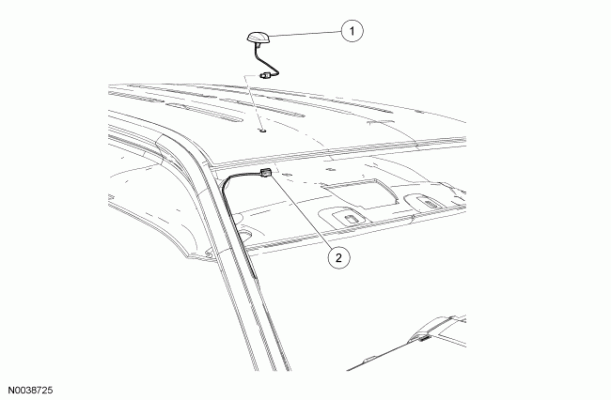

Well I got the new gps antenna installed today. Not a bad job at all.
Remove the right A pillar trim.
Remove the right sun visor and both mounts.
Pull the trim from around the right A pillar area as well as the sunroof trim.
This allows you to be able to drop the headliner enough to get your hand in and remove the bolt under the antenna.
Unplug the antenna wire and wire keeper.
Install the reverse way.
Easy as that.
In all it took me about 45 mins.

Sorry to burst your bubble Trainmaster :)
This particular radio (factory) uses the same antenna for both. The antenna connects to a splitter cable and then plugs into the head unit twice. One for the radio and one for the maps/gps.
