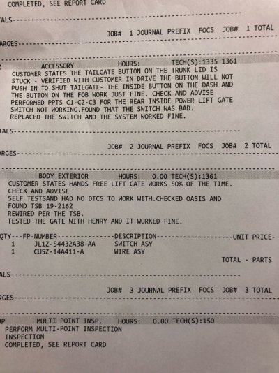

TSB 19-2162 out there for mis-wiring, see bottom half of attached pic, from today.

Had my '18 Limited into the dealer recently to take another look at this issue. According to notes, they applied steps from TSB 19-2162. Unfortunately, the tailgate still activates under the worst of circumstances (like when hooking up or disconnecting a trailer) when no action whatsoever is taken that replicates the foot-application karate kick.
Anyone else have this problem and get it resolved by a method other than TSB 19-2162?
