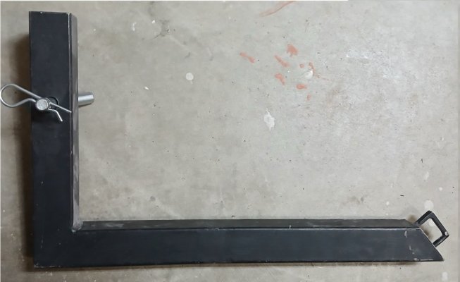

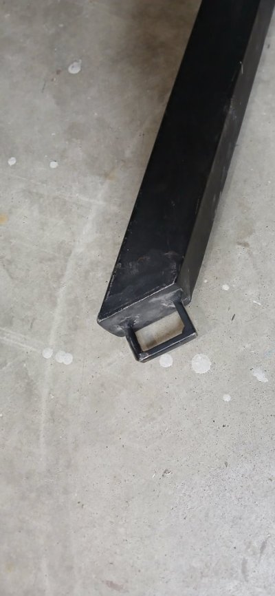

I made an extension piece out of 2x2 steel square tube that fits in the trailer hitch and allows the back hatch to latch on the top to hold 4x8 material. This keeps the door closed, doesn't allow it to bounce and holds in the 4x8 stuff so it cant slide out. If you want to haul 2x4 or thinner stuff, you will need to secure the materials with straps to keep it from sliding out during acceleration and cornering.

Cool!
Nice work.

I want to make one now too...!!! brilliant solution to the Regular Expedition length...
Cheers!!

I thought about this, even though my Expy is the EL version, but I just bought a nice, matte-black, non-slip, 18" wide step extension that fits into the trailer hitch too...
Works great as a tie down spot for the rear hatch, as well as providing an extended place to step up on if/when I want to put something on top, like those 16 ft decking boards I bought last fall, which I REALLY didn't want sticking out 10ft beyond the rear hatch :)
