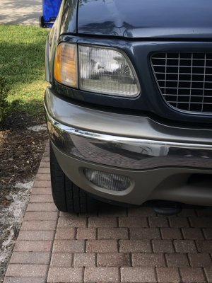

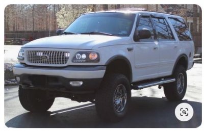

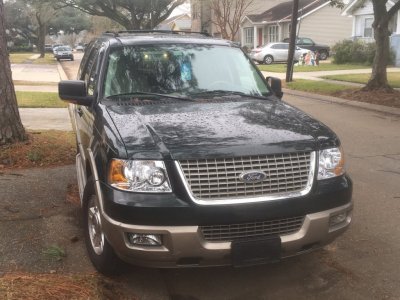

My headlamps have fogged over. I had them polished two years ago, but they look terrible again. I would like to replace them with something more modern looking-similar to the pics below (I have not purchased any of these for fear they are junk). I would like to know if some of you could share what type/brand you used or any pros/cons I should consider. The prices, brands, types are all over the place-LED, HID, Halogen, etc. I do see a similar post, but it is from 2018. Hoping to revive the topic. Thanks in advance.
