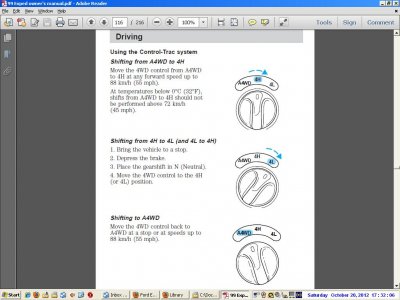

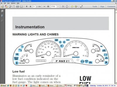

Okay it is def a 4x4 here is the issue. When I turn the key to on I see low range. When I start the vehicle I see the low range and the 4x4 lit up. If I attempt to put it in 4hi it does not light up. When I put it in N and try 4L it does not light up. I am worried that I am always in 4wd and dont know it because I feel no difference when I put in 4hi or that I do not have 4wd. Please help

As to the 4x4, there is a motor on the transfer case that the knob on the dash controls for shifting into/out of 4wd that may have failed. However, there is a sequence for getting into 4-Low that requires the vehicle to be stopped, brake applied, neutral, knob turned to 4-Low. Lights on cluster will illuminate brieifly when key is turned on for bulb check.

you are awesome thanks.... so it will not go into 4x4 okay but could it be stuck in 4x4 and the lights not be on. I did have an issue with the lights on the odometer. It is weird that the low comes on in the on position then goes off then when I start the vehicle both low and 4x4 come on and go off. I am pretty certain that I am not in 4x4 low but could I be stuck in 4x4 hi and with no light. Is there anyway to find out if I am in 4x4hi or regular AWD?

If you were stuck in 4x4 high, your truck would be kind of jumping and binding in the front when you go around a corner on dry pavement. You'd be able to feel it for sure.
