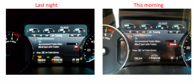

It started working on its own. Here you can see on the "Trailer Information" screen.
Also, when I turn the ignition on, it just says "trailer attached" and "cross traffic alert deactivated", instead of "trailer attached" and "blind spot & cross traffic alert deactivated".
For anyone who comes upon this thread in the future, here is everything I did between last night and this morning, although I can't see why any of this would have any effect.
Took the "last night" picture.
Did a master reset of the SYNC3 system (for reasons unrelated to blind spot with trailer)
Shut off the ignition (trailer wiring still connected to the 4-pin connector)
This morning
Unplugged trailer wiring (with ignition still off)
Turned ignition on
In about a minute or two plugged the wiring back in
Wife drove the truck to run an errand. I assume she was driving mostly between 20 and 40 MPH, just like I did yesterday when fighting with BLIS. I don't know if BLIS was already working for her when she had the truck. She drove for about 30 minutes.
A little later I got in the truck and drove on the highway. Noticed that BLIS was working.
Went into "Trailer Information" screen and saw that "Blind Spot with Trailer" had changed to "ready" (although I already knew that the system was working)
Don't know what if anything caused this changed. Maybe had to drive a few miles. Although I drove quite a few miles yesterday too, but yesterday I was also tweaking the menus all the time and deleting and re-creating the trailer. Maybe the trick is to leave the settings alone for a while and just drive.
