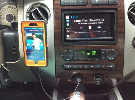

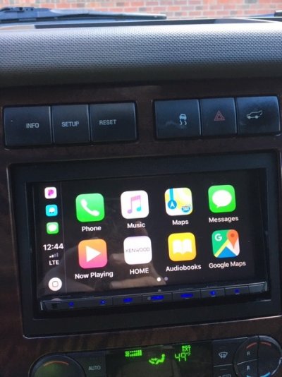

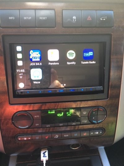

The RES goes to head phones only with after market install which wasn't a problem for me. Grand kids are the only ones that use it. There may be some work arounds.
I bought thru Crutchdfield they provided all the wiring, dash kit and steering wheel controls. about $900.00. I installed myself 99% plug and play with good instructions.
Love the new features like front and rear camera,Apple Carplay, a selection of mapping systems Google map ,Garmin, Apple,Wase, hands free text and calls,etc.

Thanks....That’s a nice and clean install. What radio is that?
