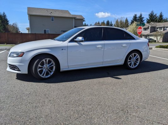

2012 Audi S4 Premium Plus White, black interior - purchased with SUPER dark all around, like 5% or something ridiculous, got pulled over 2x in that, redid the front sides to legal

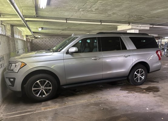

2022 Ford Expedition Limited White with the black and mahogany seats - To be done soon at match factory
