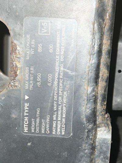

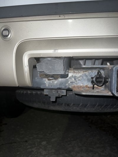

So I found a few things, our 06 expo does have the HD I saw the 4/7 connector along with the tow limits, the hitch grow weight is 5,000 and the tw is 500. With finding this out and doing so more Research I should be in the clear with a couple hounded or more to spare.

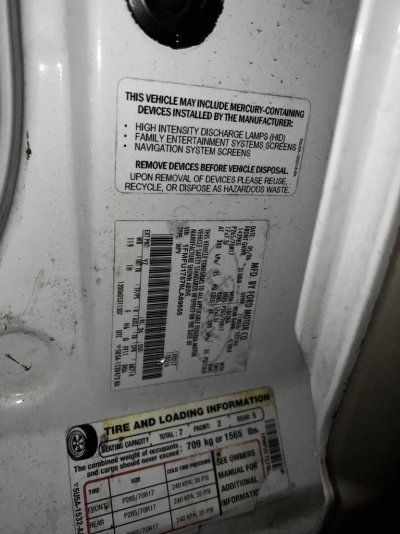

Your door sticker shows you have the 3.73 rear end that’s typically only on the heavy tow pack Expeditions. Sorry thought you knew that.
I did not, I’m somewhat new to the Expedition world, we had an 06 XLT in the past but that was when I was still in my early years of high school before I started doing my own research and really getting into cars and trucks. Having to do all the calculations is somewhat new. In the past I would just use my dads 02 Ram 1500 to pull anything.

If you have the round "Bargman" trailer electrical on the back bumper (to the right of the hitch receiver) you have HD tow -- it only comes with that option. This gives you a 9200/9300 pound maximum towing capacity assuming the truck is empty. 3.73 axles were included in HD Tow some years but not others -- my 2017 lacks them but I think all the V8s HD tows have them. Axle ratio doesn't seem to affect maximum towing capacity.
