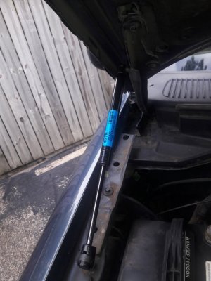

just got a 2001 xlt, truck is clean. it only has 28k miles on it.. already replaced the hood with a all steel cowl hood.. the lifts wont hold the hood up.. any body found stronger struts.. i've tried the turbolifts, cant remeber the model number , but they were some where here on the forum..

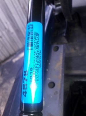

so i went to autozone and found what i need... i guess the stock hood is not made of steel, and they list a strut for the truck with a steel replacement hood. its a little bit thicker... works great... price is $25

The struts are made by Strong Arm. Just don't want to need strong arms to close the hood. :Dsteelstrut.jpg
