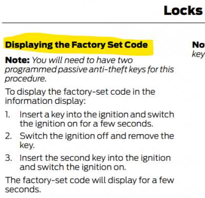

The used car dealer was unable to find the code online. I used the YouTube video with the two keys. Worked.
