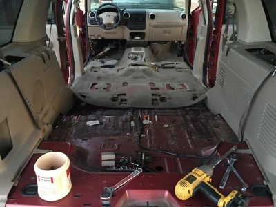

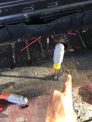

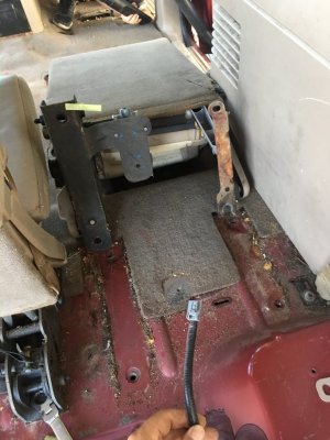

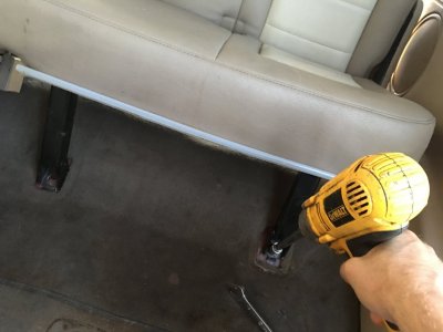

I was searching the net for a thread on removing the power 3rd row seats from a 2nd Gen Ford Expedition. I didn't find easy instructions or clear pictures for the procedures, so I went and did the project on my own and it wasn't so bad.I am posting up the pictures for anyone else that may want to remove or service their 3rd row seats.
Back Story:

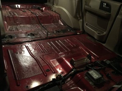

I bought two identical (except color) 2003 4x4 5.4L Eddie Bauer Expeditions that need love. The previous owner of one of my expeditions was very dirty and messy, so the first thing I did was strip the interior so that I could scrub and clean everything while the parts were outside the vehicle. After the interior was removed I cleaned the metal floor pan. This vehicle will be much nicer when I am done than when we bought it. I think I will have a lot more to contribute to the forum as I rebuild the pair of Expeditions for my family to use. Here are the pictures of removing the 3rd row seat:

I appreciate the pictures, but I don't know enough about this to understand what the finger is pointing at.
