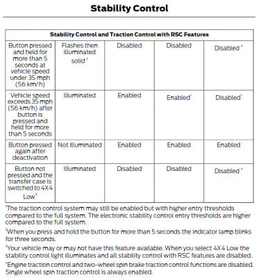

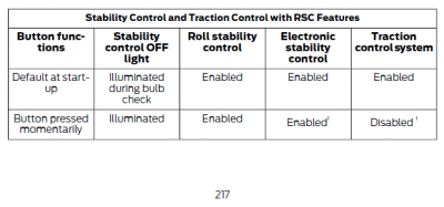

Press and hold down the traction button for 8-10 seconds continuously. MSG will pop up saying Advanced traction control off

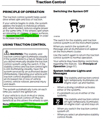

Even though you can turn-off the traction control, the stability control system remains fully functional.
