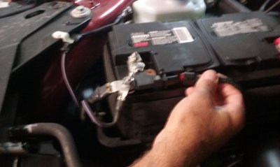

There is a simple way. Under the hood on the front battery terminal is a connector. It supplies power to the Auto Start Stop. Unplug it and no more Auto Start Stop and no having to look at the light on the dash. You will still get the indicator on the dash when you stop at a light showing A S S is not available when it would normally kick in. Actually was told how to disable it from my salesman, who'd have thought. Disconnected mine before I even left the dealership.

Can you post pics for those of us that or not mechanically minded?

Unplug this connector and tuck it down in the battery tray.

Has anyone had luck with this? Did it stop the "Auto Stop-Auto Start" system? Any negative effects like backing alarm gone, etc.?

I haven't got close enough to anything to trip the backup sensors, but the side traffic alert still works. Time to check it.
