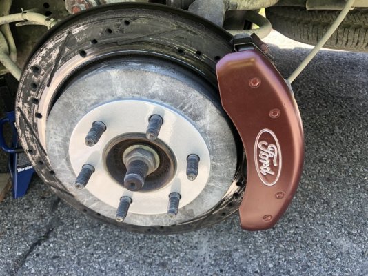

Then I swapped out the wheels in the pic above (was kinda curbed) for a set of wheels/Pirelli tires that were takeoffs from a 2021 F150...but the rear wheel center caps could not be put back on because the center bolt stuck out by about 5/8"...should I add a spacer to it to make it fit, or are spacers not advised?

Nice looking truck. Grab a sawzall and trim a couple threads off the axel end so the caps can fit. There is plenty of material there (I've done this on 3 Expy's now, no issues).
And while you're at it, swap out the lug nuts for solid Gorilla nuts or the like.

Hmmm the sawzall route seems interesting...knowing me, I'll probably F it up but that is an option.

I sawed my rears on two of mine. Piece of cake. Just cut enough off so it's done in one

I run spacer on mine and never had an issue I know some frown upon them due to safety if the spacer comes loose. But I can tell I used them for years and swapped wheels in the winter and summer and have never found a loose lug. just make sure you torque them down and you should be fine
Sawzall with a good metal blade and let it rip? Did you have to do any sanding or filing on the bolt afterwards?
