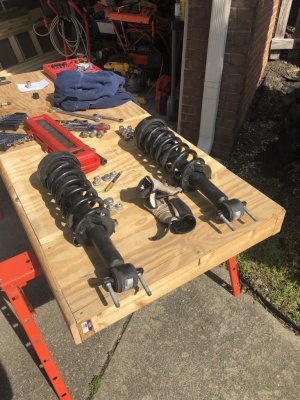

Finally got my Bilstein 5100s (front) from an F150 and Bilstein 4600 (rear) for the Expedition with Readylift rear 2” spacer on my 2016 Expedition.

If you are going to compress the springs yourself.
DO NOT even bother with one of those rental spring compressors that I call the side squeezer.
https://m.autozone.com/loan-a-tools/loaner-strut-spring-compressor
I could not compress it enough with this unit.
Rent one of these instead. Takes a little coordinating because most stores do not have them but you can have it shipped to your house or store.
https://m.autozone.com/loan-a-tools...erbuilt-strut-coil-compressor/537058_0_0?aqs=
Or just remove the strut assembly and take it to a shop to be compressed. Won’t cost much. I got lucky neighbor owns an auto shop and does lots of work at his house happened to ask him if he had a compressor at the house I could borrow. He did not but told me to run the assemblies to his shop and they would take care of it.
So I did not have to fight/destroy the OEM shocks like NASCARMike did to get the perches off. HUGE time saver. I ate at Wendy’s while they did the hard stuff. He said they were a beast to get off.

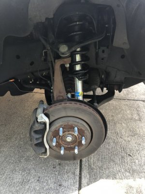

If you opt to use the 5100s instead of a front spacer the lift amount specified for each notch in the instructions on the strut (spec’d for the F150) DOES NOT, I repeat DOES NOT correlate to the lift for our Expeditions due to different spring rates. I did not expect such a huge difference between the lift rates. I set it at the highest notch which is 2.1” (spec’d for the F150) I got 4” of lift which is WAY to much lift.
So I got the joy off pulling all apart and doing it again at the 2nd notch which is .79” (spec’d for the F150) and I got right at 2” of lift.

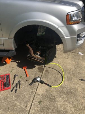

I had to remove the front sway bar end link top nut on both sides. The sway bar would not lift off the end link without both sides removed.
Fully tighten your front lower strut mount bolts/nuts to the lower control arm before sliding the axle shaft back into the knuckle. While it can be done with a wrench the axle is right over top and makes it very very hard to get to. Save yourself some time and tighten them down before bringing the knuckle back up.
