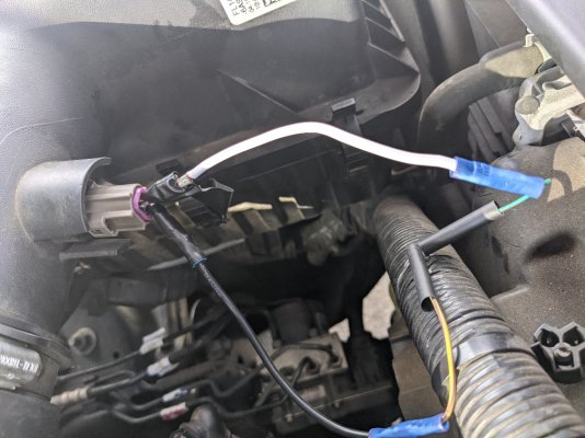

@Yupster Dog I got a Doorman sensor from the parts store and it came with the new plug end so I spliced it on while waiting for the Ford part. Didn't resolve the issue. Code came back immediately on startup. Put the new sensor in and spliced on the original plug. No dice.

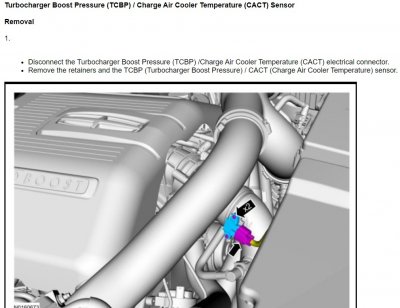

How about the other sensor on the turbo pipe? There is some confusion on my part on the differences between the IAT and Air Charge Temp Sensors... The one I bought was called Air Charge Temp sensor by ford, but the code is for the IAT bank 1 sensor 1. Forscan does not show a sensor for bank 2. Maybe I need to look at that other sensor? I can't remember the name of it, but it's on the turbo pipe below the fuel pump, driver side.
Sent from my Pixel 4 using Tapatalk

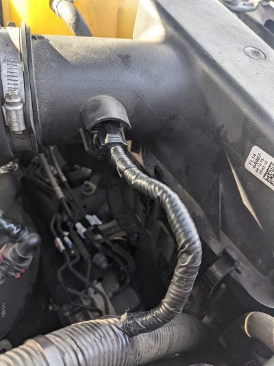

OK, here is the other sensor I was referring to (attached). It is labeled as "TCBP (Turbocharger Boost Pressure) / CACT (Charge Air Cooler Temperature) sensor" which is why I'm second-guessing myself now. Can anyone clarify whether my symptoms would be caused by this sensor failing?

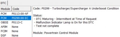

It's worth noting that DTC now shows an underboost P0299 code as of this morning.

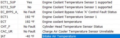

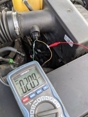

@Yupster Dog that would only apply to the reference wire though and we've already confirmed 5v at the sensor. It's the signal wire that is the wild card here, right? -40° I beleive is the max "bottom" range of the sensor, so I'm not sure if that tells us anything. I was thinking if the PCM was faulty, it could be interpreting the sensor incorrectly and causing the lean condition. Just a thought.

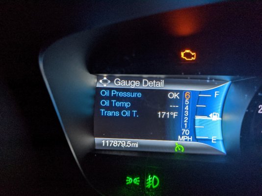

For what it's worth, the oil temp is not showing any more. Am I crazy in thinking maybe the PCM is shot? With the p0113 and p0229 codes showing up at the same time, and now the oil temp gone, unless I'm mistaken all three of these sensors communicate directly to the PCM, right? Oh, and now it's showing the IAT code p0112. Could replacing the PCM be my magic fix? Any way to verify this?7c86ef43a913641e6c68895ea2a30d5b.jpg

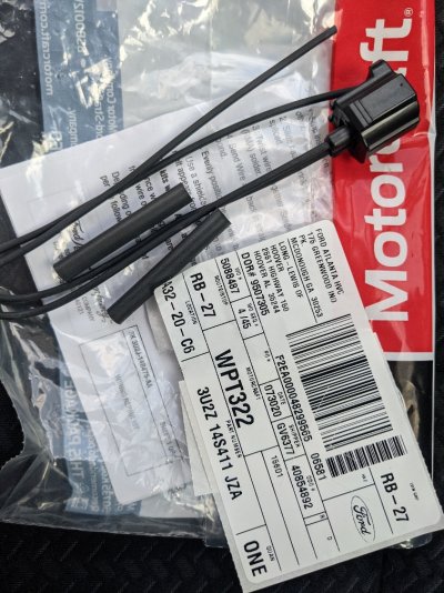

Only other thing I haven't done yet is replace the factory IAT connector. It's on order and I'll install as soon as I get it just to rule that out, but the existing doesn't show any defects.

I received the new Motorcraft connector, spliced it on and problem solved. Reset the DTC and all codes gone. Engine running smooth after an 800 mile trip with the travel trailer.

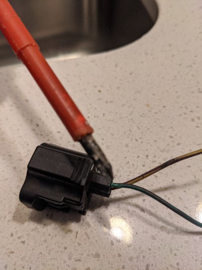

I decided to investigate the original connector and found that the reference wire was broken inside it's jacket. I found a little white stretch mark so i pulled on the wire and sure enough, it stretched. I spliced it all back together (I was still waiting for the replacement connector at the time), reinstalled it and my problems disappeared.
Now we know - if this sensor/connector is defective you can expect multiple DTCs indicating turbo underboost and/or misfires. The engine oil temp readings will also disappear from the driver display. It's worth noting that the -40° I was seeing for air temp is actually where the sensor signal bottoms out. I beleive it tops out in the other direction at 280°. I got both readings at different times.
I'm attaching a couple photos for the historic record.
