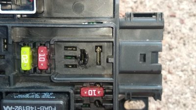

I think I got it.
I swapped out the fuse box for my spare and the middle pin on the C2160 PCM Relay is melted (See picture). I also used a new fuse in the replacement fuse box.
After getting her all back together and the negative terminal reconnected I cranked her up and she started up immediately as she normally does. I no longer had the extended cracking time post grounding.
I haven't warmed her up yet to run ForScan or to take her on the highway to see if the Check Charging System CEL still flashes so I'll update after I do but for now, one symptom is gone.
