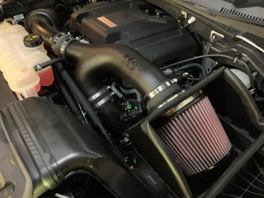

Well I turned my 2018 Max Limited in for a 22 Timberline. I wanted a K&N cold air intake for the 22 but K&N does not have one available. I Removed my K&N cold air intake from the 2018 before turning it in and being an engineer and a gear head I figured lets see if the old unit would fit the new truck. Long story short, after a quick trip to Lowes I niw have a fully functional cold air system. All the original 2018 parts fit perfectly on the 2022. Had to plug one opening and drill another for the intake sensor.
just wanted to put this out there if anyone is interested in wanting to run a cold air intake. I can provide the details and pics if needed.

Post some pics of that Cold Air Intake!! Does it sound better? More turbo noise?
