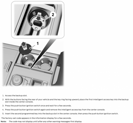

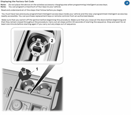

For my 2020, I found a procedure for obtaining the code using the key fobs and the slot in the cup holder. You can find it in the online Owner's Manual at Ford Owner Support. Maybe in the printed Owner's Manual as well. You need two functioning fobs for this to work.

Yes, this. Just went through the procedure and at the end the dash displayed the factory code
