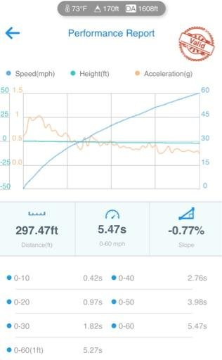

Got this on my Limited SE Max 4x4 with 22’s using the technique above.
This was a ZFG 93 Tune in “Drag” Mode.
Two thoughts. First, didn’t the stock one run 6 sec? I would have thought the tune would have taken off slightly more than that. Second, really curious if there’s a discernible difference between tow vs non-tow gearing.
What app is that, or is it the tuner?
I don’t base my times off numbers gotten from journalists on a track. That is perfect world. Mine is a the worst combo for good 0-60 from a weight, and unsprung weight. Limited, Long, with 22’s.
6.4 was my 0-60 stock with 93 in the tank. So that is almost a second off of factory with just a 93 tune. Impressive for this weight vehicle.
4x4 helps with traction, but adds weight. And I do have the Heavy Tow package. So 3.73’s, that helps with the launch.
The app is Dragy, it is not just an app, it talks to a VERY accurate little GPS device. It is just as accurate as being at a Track, the “apps” that others use, are not, because they use the phones GPS or the cars speedometer via OBDII. Both are inherently inaccurate.
