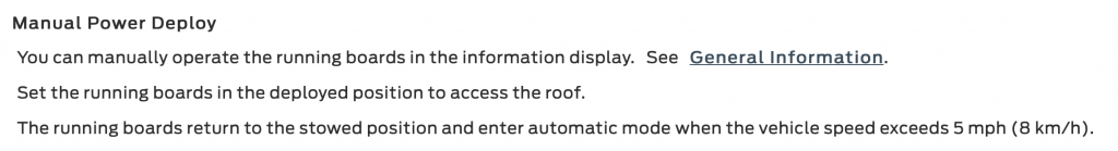

I haven't verified yet in the 4th Gen, but our 3rd Gen would not keep the boards deployed beyond one engine on/off cycle. You could deploy them while the car is running and they would stay out after shutdown, but would retract again on the next start. Perhaps 4th Gen behaves differently.

I wouldn't keep them down as they will take a lot of abuse and could get caught up pretty easily. If they snag on something things can get ugly fast. If you want to go that route I would swap them out for fixed running boards that don't hang down so low.
As for lube, standard WD40 is a terrible lubricant. It's good for rust removal/protection and that's about it. However, I do like the WD Specialist white lithium grease and have used that on the running boards. No matter what you do, they are very likely to fail. I am on my 3rd set now I think and gave up replacing them. I unplugged the driver side and for now the passenger side continues to function.
