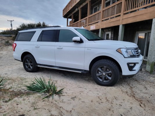

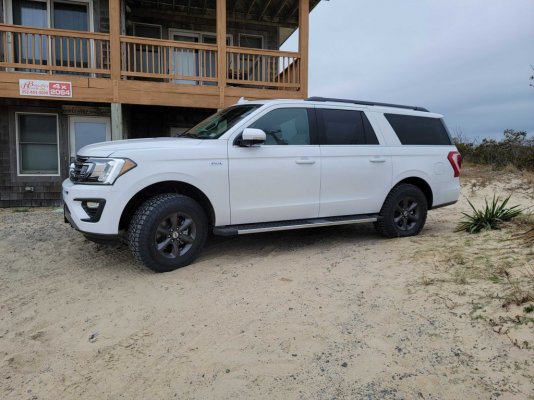

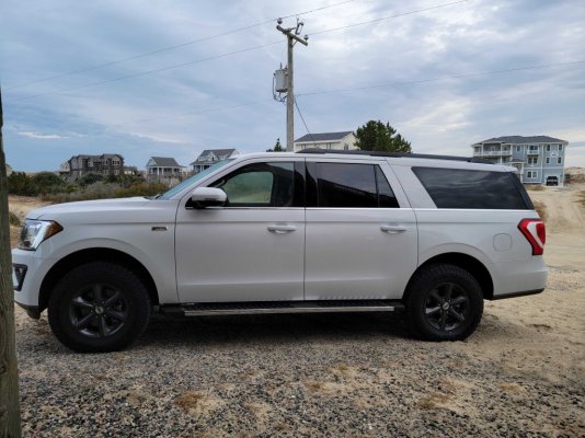

So...I did the Expedition Bilstein 5100s on all four wheels at max setting (1.6" lift), so that I could run Toyo Open Country AT3s in 285/75R17 (33.83" diameter) on Method 705 wheels (17" with 25mm offset).
But I still don't have those on the truck, so I only *think* it'll work. Have not actually tested that combo yet. Stuff is back-ordered with no timeframe given, so for now I put Falken Wildpeak 275/70R18s on the stock FX4 wheels, which seem good, but haven't been off-road with them yet.

Thanks Bob! Do you by chance have a photo with the wildpeaks on the stock wheels?

Here you go. Took the truck to the beach. Falkens are at 17psi in these pics. So far so good on the beach.
