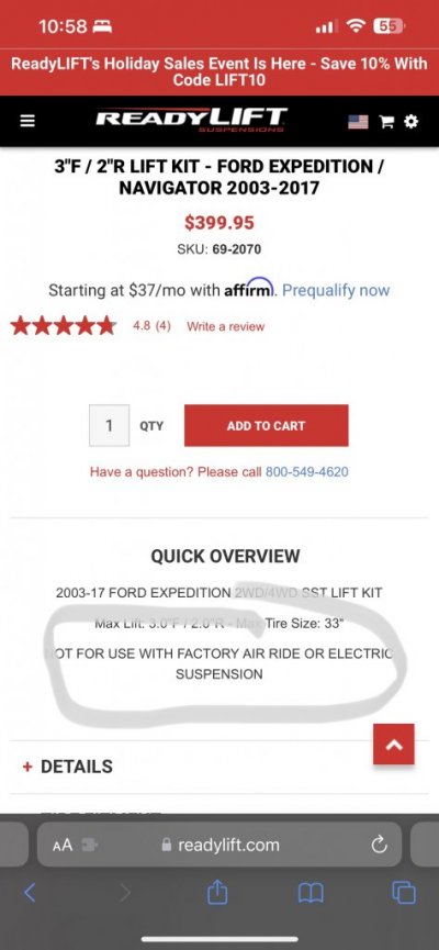

Hey guys been searching for the right answers for a few weeks now and haven’t found a solid answer. Seems like my body styles not a very common one to be lifted?
I would like to do a 3/2 with ready lift. The trucks got air suspension/ccd/and self level with a trailer hooked up.
It looks like on the 18+ the rear struts need to be swapped from side to side and add some adjustable arms for the ccd? Is that all the same for mine a 2016?

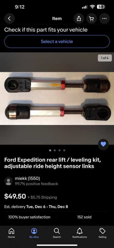

So do the ride height sensors work with the CCD? Most the online things Iv read that talk about the RHS are talking about air bags. I guess that’s what’s been confusing me.
I found adjustable arms for theRHS wondering if that’s all that’s making these kid not work with certain suspension

My 2012 EL has the rear air suspension and I had a 4x4 shop install the Readylift 3/2 kit on it a year ago. The tech said he just disassembled the air struts and rotated the bottom portion of the struts so they would mount in the original factory location. I told him about switching the rear struts from side to side but he said the upper portion of the struts wouldn't fit on opposite sides due to the connection for the air supply lines not fitting under the strut towers. Note you don't need the aftermarket adjuster leveling arms. I purchased them too but the factory arms work just fine. I have no clue how to disassemble the struts but maybe there's a youtube video. Best of luck.
