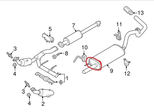

I only got a brief look before the tow pulled away. The only thing I could tell was the fuel was dripping from the exhaust system just in front of the passenger-rear tire. I've circled that area in the attached diagram. But, that's just where it was dripping from the car to the tow bed, no clue where the actual origin was.
I started wondering if the fuel was excess from the failed starts? Flooding the engine? Scary that it could find its way to readily to the (potentially very hot) exhaust system components. I don't know enough about these cars to know if this should/should not happen in the case of failed starts.

There is/was a small hole at the bottom rear of the muffler for condensation to weep out. If you had a stuck injector and it was dumping fuel, the fuel could have passed by an open valve and into the exhaust.
I had a stuck float on a holley 850 back in the day and it created almost the same scenario. You might want to have them change the oil as you probably have a load of gas in it or at least check the level or the viscosity before starting the engine.

Just received word from the dealer...
Cause of the fuel leakage is exactly as @Fastcar suggested: Stuck open fuel injector (cylinder 6 to be specific). Good call @Fastcar! (I relayed them your comments, btw. So, thank you very much for throwing it out there.)
As to whether or not the stuck open fuel injector was the cause of going into limp mode in the first place vs a biproduct of all the failed starts thereafter, dealer says they won't be able comment on that until they're further along in the work to resolve the stuck injector.
