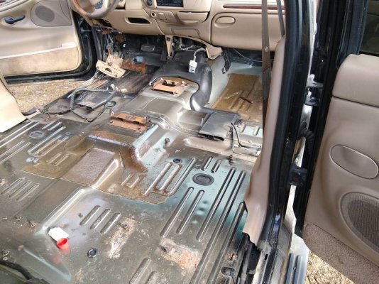

    Pretty neat! you are on your way to restoring it!

    That just looks like it needs some Extend or Ospho sprayed on then I would coat in thick paint or rubberized undercoating.
