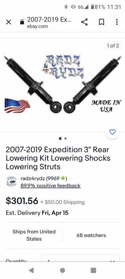

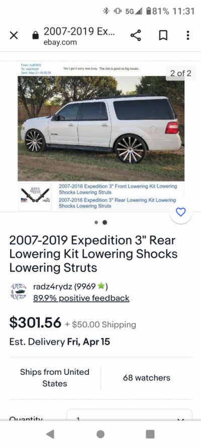

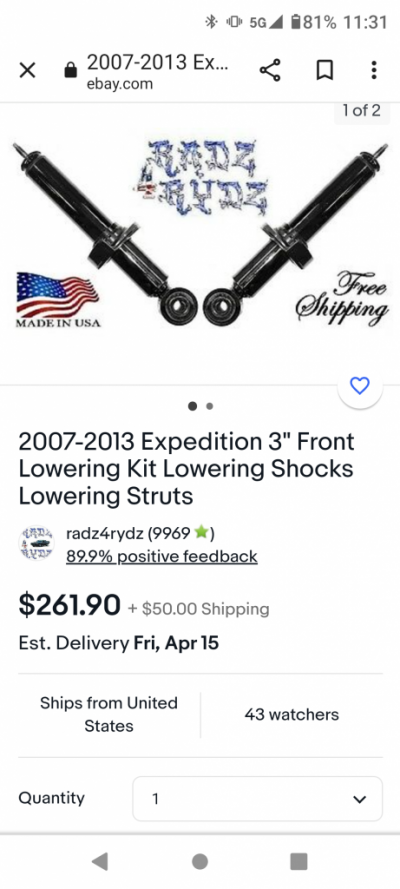

Look on eBay. I purchased lowering struts. Basically replacement struts with modified spring perch lower on the strut body. I’m running the 3 inch drop. When new they were great but since they use a Monroe type replacement fronts are a bit weak now. They’re advertised as lifetime warranty so I’m in the process of replacing the front hopefully with a better strut.
