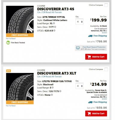

I am doing early research on replacement tires for my 2017. Not looking for brand wars, but on similar load capacity and model of tire, what's the noticeable difference between P tires and LT tires? The P tires would be XL versus LT tires of Load E. I do have a 5,800# empty / 7,500# loaded travel trailer that I tow a dozen times a year <200 miles each way.
Here's an example for easier reference - again, not a brand war.P tire vs LT tire.JPG

In my experience, the LT tire will be tougher. It’s going to wear longer and have a stiffer sidewall (thus the higher load capacity). But it’s going to ride harsher.

Don't think wear has any relation to LT vs P. Only tread wear rating. Of course is all the LTs have better numbers then...there ya go.
LTs often have a better square cut look to them. I like.!!
Check on the load rating. I don't think you need an E.
Even Excursion factory came with only D I think and it was a beast.
Each one will list max load.
I think a D or E is a good deal higher load than a XL P tire but the numbers would tell you.
E are 10 ply and typically (all that I've seen) max inflation of 80 psi. I'm not running an E around out 35 PSI but that's a whole other debate. BUT an E could very well ride harsher than a P tire. They do have a lot more strength and stiffness going on in there.

I've gone to the Light Truck version of tires for a couple of reasons (vs P). Run Falken Wildpeak on my 2003 and Kumho Road Venture on my 2014 at the moment. I have found them to be slightly louder than my P tires but that could just a result of increased tread depth. They might have a slightly harsher ride but no biggie. I may not even be able to detect that, not sure. The LT tires always have deeper tread depth than P so that's a reason to go there. They are 10 ply (or the equivalent of 10 ply since there really aren't all those plys anymore) and have tougher sidewalls. That's good off road if you scrub a rock and it cuts the sidewall. The LT's will be more resistant to that. Main design goal with LT's is the increased weight they can support. If you load up 250 bags of free compost in the bed of your Expy that's a lot of weight on the tire and LT's can handle that load. But to make that work you have to inflate the tire to a higher pressure. In fact, even with no extra weight you are supposed to run a higher pressure. There are tables to determine that. I run about 46 psi in mine all the time. I'm not a tow guy but from what I read you don't need LT's to tow although it can't hurt can it? After two Expo's with LT … I see no downside … from my own personal experience.
For example those Cooper Discoverer AT tires
- the P version is 14/32" tread depth
- the LT version is 17/32" tread depth
So, common sense says it will wear longer … since it got more tread to wear through.
