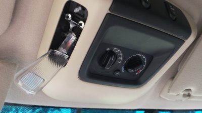

Why can't I find ANY INFORMATION on the map (or is it dome?) lights ANYWHERE?? The lights are on each side of the console in front of the moon roof on my 2003 EB.
Not only is the fitting broken, I can't even seem to find a spec on what bulb to use!
Please help!

Herb, this an easy one. The console pops right down after removing a few screws. The bulbs are listed on every website, rock auto had them under map light. For what it's worth I'd buy the bulbs from Ford. Price is the same as the better Sylvanias, and last way longer. Looks like the #912 bulb that I use in my 3rd brake light, but I could be wrong. The overhead has a couple of screws, and theirs a tab that tucks into a piece that comes down from the roof. Easy peazy!

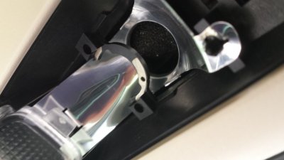

The bigger problem is that the socket itself is broken so the bulb won't stay in and there isn't enough of the broken copper contact left. I might just try to Jury rig it....

Get another socket, either tie wires and solder, then shrink wrap, or the cheating way, clip wires expose back 1/2 inch wire, use a couple of red crimp connectors. It's indoors, no corrosion worries, that's the way I'd do it. If dealer or parts store can't help, go by a pick and pull or equivalent, and snip off what you need. It's what I've always done over the years. Wrecking yards are good for you. Brings out the grunt in you. It's the male equivalent of a woman's shoe store!

BTW: In response to the OP's question, I replaced all my map lights with LED's. Been very happy with these. I know you have a broken socket, so it's not a straight plug and play type deal, but maybe instead of a new or junk yard socket you just solder in a led and call it done
