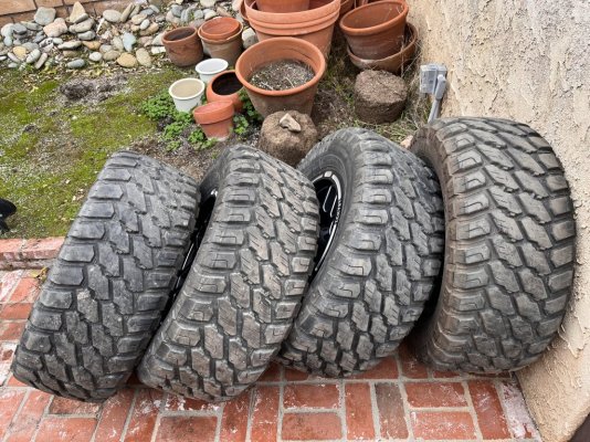

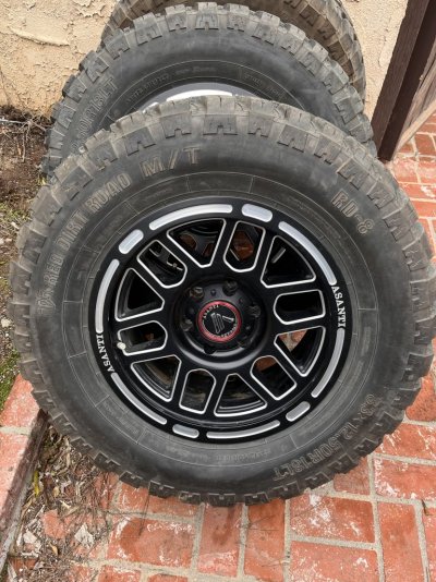

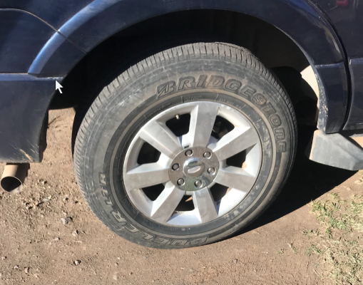

Hello,
Just started working on an Island where we have around a 50 min drive into town on primarily dirt roads where a few stretches definitely require 4x4 with steep and sharp curves and softball size rocks of varying sharpness. The organization I am working for currently has two Expeditions ... a 2010 and a 2013. They both have original street tires and they have taken a beating. I am trying to get them to upgrade and get some better tires.
I came across an ad on the island where a guy is selling some tires and rims that he had on his Ford Ranger. This would work great for us as we wouldn't have to ship them to the island and the price seems reasonable for the condition.
Question is will these fit the 2010 0r 2013 Expeditions?
Asanti Rims
Red Dirt Road M/T RD-8 33x12.50R18LT
$900 for 4 Tires and Rims.
Currently vehicles I assume have stock tires and suspension and no lift.
2013 Currently has LT265/70R18
2010 Currently has LT255/70R18
Attached are some pics of current set up (one of each vehicle) and a few of the tires for sale.
Any input or thoughts would be greatly appreciated.
Thanks,
brian

The Ranger tires will not fit. Rangers run a 6x113.5 bolt pattern and Expeditions run a 6x135. Could get some Raptor rums and tires and Ready lift.
