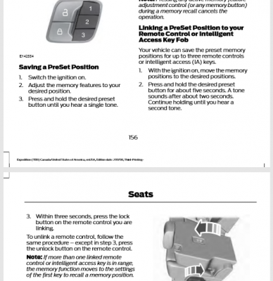

I am going to guess she is using your keyfob. In that case, Seat Position #1 is paired with that fob and every time the car starts up with that fob, it will revert to position #1. Try setting up the other fob for seat position #2 and have her try that one...I am going to bet it will always default to position #2 for her.
Linking a PreSet Position to your Remote Control or Intelligent Access Key Fob
Your vehicle can save the preset memory positions for up to three remote controls or intelligent access (IA) keys.
  1. With the ignition on, move the memory positions to the desired positions.
  1. Press and hold the desired preset button for about five seconds. A tone sounds after about two seconds. Continue holding until you hear a second tone.
  1. Within three seconds, press the lock button on the remote control you are linking.
To unlink a remote control, follow the same procedure – except in step 3, press the unlock button on the remote control.
Note: If more than one linked remote control or intelligent access key is in range, the memory function moves to the settings of the first key to recall a memory position.

So I left my FOB in the house (about 30 feet away) and used her FOB as suggested. Upon start, it automatically moved to position #2. I held the #2 button down and after the two beeps immediately pressed the lock button on the FOB but, upon turning power off, it still returns to the #1 position.
I did subsequently find that section in the manual - thank you!

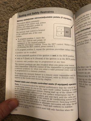

Not sure if it helps at all as we are totally different years but maybe it’s similar. The manual on mine says the positions for seat position 1 and seat position 2 are in relation to the fobs when programmed correctly. However if never done right it isn’t. The computer will put the seat position to which ever key is with (1 or 2) when you hit the unlock button on the fob. If the vehicle is already open and set to #1 it will default to setting #1 if I’m reading it correct. Did you try locking the truck and unlocking with her key fob? Also to program it to her key fob use hers to open truck then program again (possible it’s not done correctly).

It's the entry / exit setting. It is confusing y'all as your driver settings must be similar to the exit settings.
Check out the manual re: entry/ exit settings
