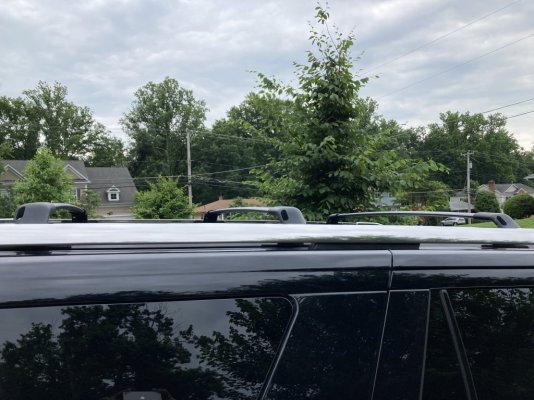

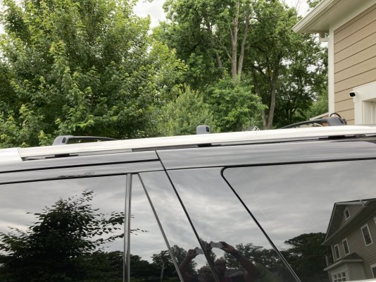

I purchased a rear rack from the dealer and installed in the middle. Really helps with stability to the Roof carrier, as mine was flexing a bit.
